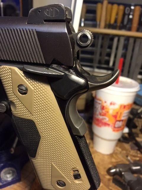

So the factory grip safety on my S&W LW Commander has always bugged me. Very poorly fit. The hole for the safety is well oversized, and the part that goes into the tang is very undersized, so the whole thing just rattles. Well I had been told forever that S&W has their own unique radius and that I was just pretty much stuck with it. Come to find out, that "unique" radius is just a Wilson double radius. Once I learned this, I found a NOS old school Wilson 66B grip safety and fit it to the S&W; all is well.
Before
After - Check out how that thing curls up...that's old school right there!! And not a hint of slop, she fits the way she ought to fit.

That is old school! Looks great Kevin. Sure is neat when something that's been bothering you turns out to be something you can fix.

I always preferred the upswept beavertails myself. I think I used Kings Gun Works safeties on my own pistols. I viewed the original beavertails as just a relocated thing to jam your hand into.

Pinning the grip safety, now that IS old school Sam. I don't know about pinning, but I may make some changes to this grip safety. My S&W has the Schwarz system so full depression of the grip safety is necessary to ensure the firing pin block is disengaged. Well the one negative of the old school Wilson is that it doesn't fully depress quite as easy; kinda have to put a death grip on it. And that doesn't really work for me because my "death grip" comes from my support hand, with my strong hand actually rather relaxed on the gun. So I may end up scrapping the Schwarz system altogether, and then finely tune the grip safety to where it only takes the slightest hint of pressure to disengage.
I for one always felt that pinning was quite unnecessary. Why permanently modify the frame of the gun rather than just filing down the engagement of the grip safety?

Sounds like Tim and I hold the same way, as that's a constant issue with me also. I get around it by tuning the grip safety for a very early release; very early.
