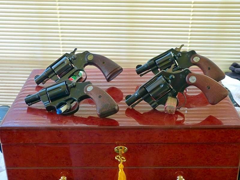

Several years ago I found one in rough cosmetic shape, but perfect mechanical condition; I was looking for a working gun, not a collector. This is a first series Cobra with the longer grip, and I've added a Tyler T-Grip. I have tuned the action to be smoother than an out of the box Python. Great revolver.
